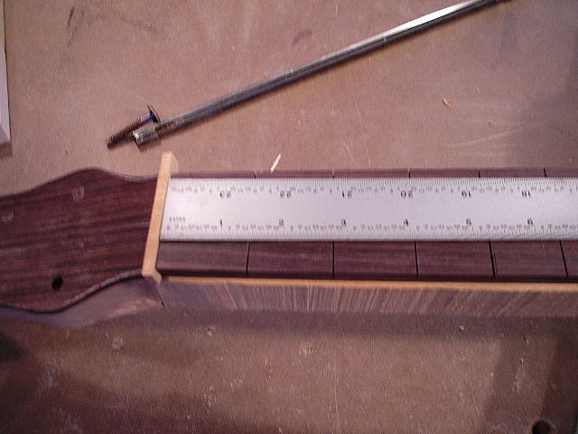

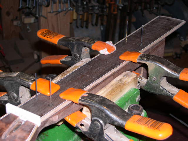

Ok, I didn't discover the cure to cancer but thought other newbie's (like myself) might use something I came up with to help align the fingerboard. I was wondering how to place the fretboard for glueing so that the frets would be at the correct distance from the nut. I cut a scrap piece 3/16" and placed it where the nut would go then placed my ruler to check the distace to the frets. I cut my fingerboard a scosh long and filed down until I was happy with the measurement. Then when glueing I butted the fingerboard up against the spacer and pressed the fingerboard down on to a couple of sharpened nails. After clamping I remove the spacer to clean up any glue that may of crept into the nut slot. Clinton

PostPosted: Thu Apr 27, 2006 12:56 am
That's funny, three almost simultaneous posts.
Steve, that's how you solved your problem, aha. That looks like a guitar on accupuncture treatment!

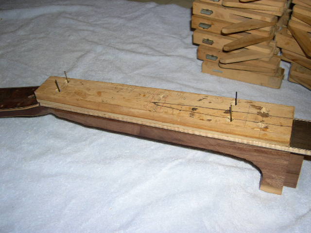

I glue mine face down into a radiused caul, hence the need to have no pins protruding. I really like the Martin roll pins they send out on their kits, but haven't determined how to do that accurately, so I can up with the aluminum dowel pins through the slot method.
It's cool to see how creative everyone is.... and all at the same time...
PostPosted: Thu Apr 27, 2006 2:33 am
Posts: 381
First name: Wayne
Last Name: Clark
City: Driftwood
Terry,
Thanks for the pictures! I just might have to steal that process.

I do it much the same way Terry does, using wooden dowels and a aligning jig, the dowels can be sliced through pretty easily when removing the FB.

PostPosted: Thu Apr 27, 2006 3:05 am
Thank you very much Terry for these great explanations and pics, it's sure gonna be helpful like all your posts generally do!
Thanks also Lance for the thought, i used nails on my first neck-fretboard alignment but wood dowells make more sense yeah!
